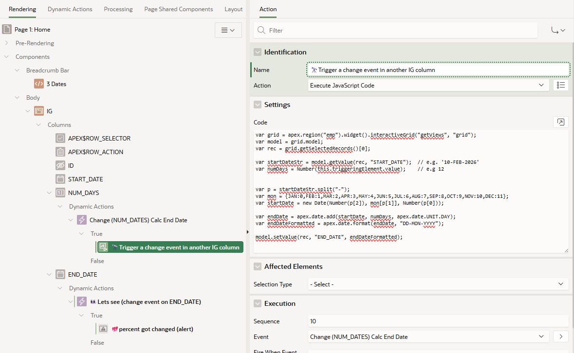

    Based on my START_DATE, NUM_DAYS, and END_DATE example above… hopefully these screenshots will help.
    First, there is a change event on NUM_DAYS. So that when the user types in a value. It adds NUM_DAYS to START_DATE and sets END_DATE.
    var grid = apex.region("emp").widget().interactiveGrid("getViews", "grid");
    var model = grid.model;
    var rec = grid.getSelectedRecords()[0];
    var startDateStr = model.getValue(rec, "START_DATE");  // e.g. '10-FEB-2026'
    var numDays = Number(this.triggeringElement.value);    // e.g 12
    var p = startDateStr.split("-");
    var mon = {JAN:0,FEB:1,MAR:2,APR:3,MAY:4,JUN:5,JUL:6,AUG:7,SEP:8,OCT:9,NOV:10,DEC:11};
    var startDate = new Date(Number(p[2]), mon[p[1]], Number(p[0]));
    var endDate = apex.date.add(startDate, numDays, apex.date.UNIT.DAY);
    var endDateFormatted = apex.date.format(endDate, "DD-MON-YYYY");
    model.setValue(rec, "END_DATE", endDateFormatted);

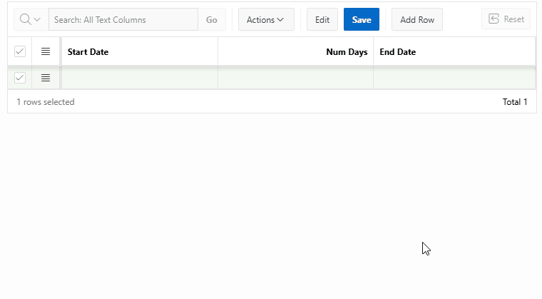

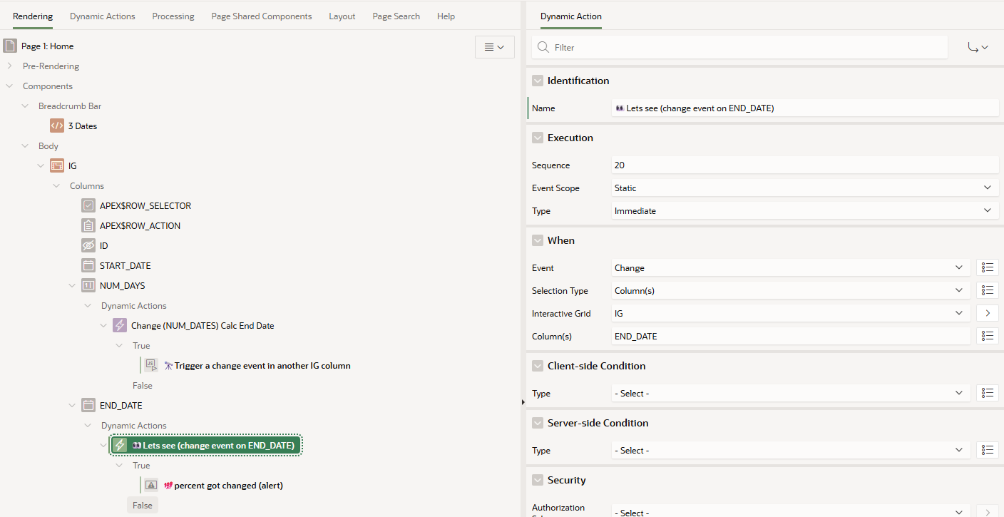

    The IG END_DATE column has a change event on it which fires an alert
    Here it is in action. I enter the START_DATE, then END_DATE and then tab off.
    Therefore proving that:
    apex.model.setValue 100% triggers a change event in another IG column.

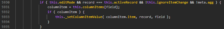

  • karel ekema OP 4 weeks ago
    Allow me to add a remark which hopefully is clarifying:
    It is possible that something subscribes to model notifications and turns a “set” notification into a change event but grid, and tableModelViewBase do not do that. So from code inspection there is no change event on model setValue.
    In case that model ‘set’ notification involves a record which is equal to the grid active record, it will trigger (indirectly via the model subscription in the view layer) a _setColumnItemValue() in widget.grid.js
    which will trigger the change event (widget.tableModelViewBase.js):

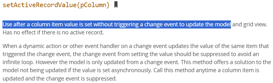

    I feel the solution for the given use case and given script is to use:
    apex.item('end_date_static_id').setValue(endDateFormatted, null, true); // pSuppressChangeEvent = true
    and then use grid.setActiveRecordValue()
    or alternatively resolve it fully on the model level using model column calcValue function John was referring to.

    Another thing that has been asked/suggested is why can item.setValue always update the model regardless of if the change event is suppressed.  Then you wouldn't need setActiveRecordValue. The reason is that we don't have control over how customers have implemented setValue in their item plug-ins. We already impose the need to trigger “change” even for programmatic updates because of DAs and LOV cascade. We did not want to impose another rule to follow (whatever it may be) so that model data is updated.
    We believe that tableModelViewBase setActiveRecordValue and model calcValue are sufficient ways to accomplish dynamic updates that may involve circular references.
