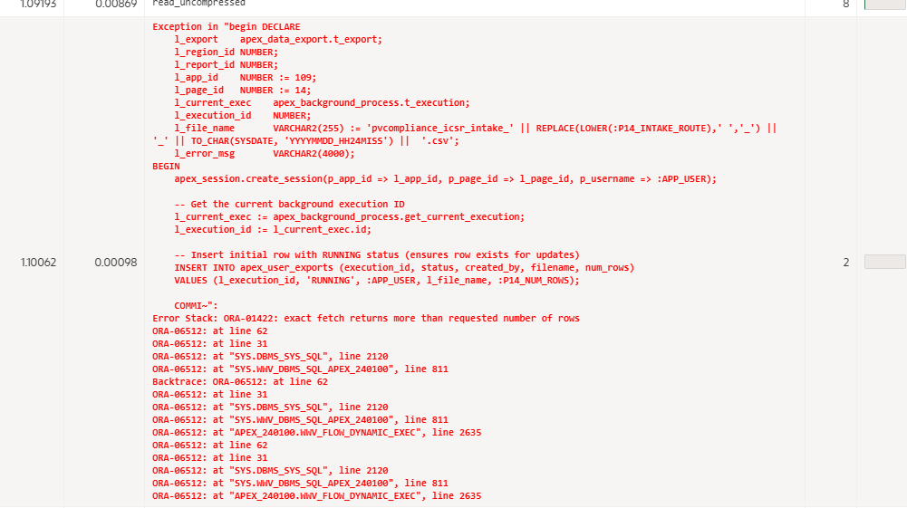

    DECLARE
        l_export       apex_data_export.t_export;
        l_region_id    NUMBER;
        l_report_id    NUMBER;
        l_current_exec apex_background_process.t_execution;
        l_execution_id NUMBER;
        l_file_name    VARCHAR2(255) := 'pvcompliance_icsr_intake_' || REPLACE(LOWER(:P14_INTAKE_ROUTE), ' ', '_') || '_' || TO_CHAR(SYSDATE, 'YYYYMMDD_HH24MISS') || '.csv';
        l_error_msg    VARCHAR2(4000);
    BEGIN
        -- Get the current background execution ID
        l_current_exec := apex_background_process.get_current_execution;
        l_execution_id := l_current_exec.id;
        -- Insert initial row with RUNNING status (ensures row exists for updates)
        INSERT INTO apex_user_exports (execution_id, status, created_by, filename, num_rows)
        VALUES (l_execution_id, 'RUNNING', :APP_USER, l_file_name, :P14_NUM_ROWS);
        COMMIT;
        -- Get region ID using binds (ensure :APP_PAGE_ID is fully spelled)
        SELECT region_id
        INTO l_region_id
        FROM apex_application_page_regions
        WHERE application_id = :APP_ID
        AND page_id = :APP_PAGE_ID  -- Fixed: Full bind variable
        AND static_id = 'intake_region';
        -- Get the *current* report ID (captures last viewed saved report with its state/filters)
        l_report_id := APEX_IG.GET_LAST_VIEWED_REPORT_ID(
            p_page_id   => :APP_PAGE_ID,
            p_region_id => l_region_id  -- Fixed: Use NUMBER region_id, not static_id
        -- Fallback to primary/default if no last viewed report
        IF l_report_id IS NULL THEN
            SELECT report_id
            INTO l_report_id
            FROM apex_appl_page_ig_rpts  -- Note: View name is case-sensitive in some envs
            AND type = 'PRIMARY';  -- Fixed: Correct column for default report
        END IF;
        -- Export using current report ID (applies saved filters/sorts/etc.)
        l_export := apex_region.export_data(
            p_format      => apex_data_export.c_format_csv,
            p_page_id     => :APP_PAGE_ID,  -- Page ID (not app ID)
            p_component_id => l_report_id,  -- Now uses current/primary report
            p_as_clob     => FALSE,         -- For BLOB output
        -- Update with BLOB and set to COMPLETE
        UPDATE apex_user_exports
        SET export_blob = l_export.content_blob,  -- Matches BLOB
            status = 'COMPLETE'
        WHERE execution_id = l_execution_id;
        COMMIT;  -- Commit the update
    EXCEPTION
        WHEN OTHERS THEN
            l_error_msg := SQLERRM;
            -- Log error (row should exist from initial INSERT)
            SET status = 'ERROR',
                error_msg = l_error_msg
            COMMIT;  -- Commit error update
            RAISE;
    END;

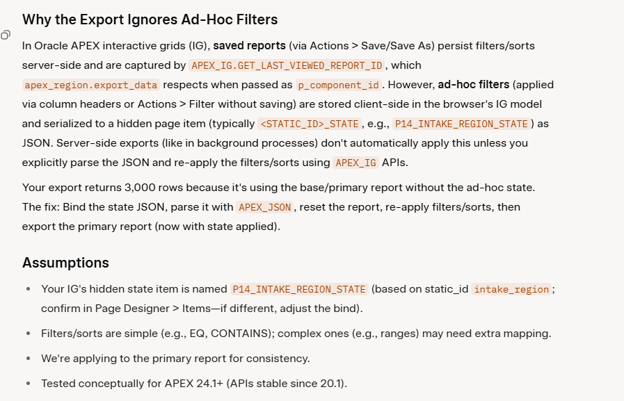

  • sjmackenzie40 OP 7 months ago
    this last code returns 3,000 rows in the export despite the UI being filtered to 18.  When you can demonstrate a working example, I will accept the idea being cancelled.  it is supposed to be a low code framework, my suggestion is simply to add a “download in background” option, which reflects the live UI state, and lets you specify where the download should be stored.
